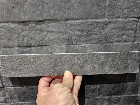

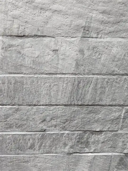

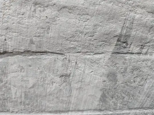

Wall currently
[Wall zoomed in][2]
[With original tile for comp][3]
Diana H.
Oh. The Installer used a putty knife to wipe across the tile to push the grout in instead of a hard rubber float and then wiping, leaving the knife edge marks. Use a solution of sulfamic acid to etch the grout off the face of the tile along with a bronze wire brush and a lot of elbow grease.
