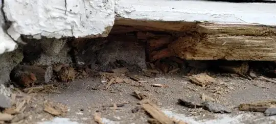

I am replacing much of a rotted window sill (in a Victorian built in 1910) The stool (wood over the sill) is fine, and ideally I'd want to extract the sill entirely and put in new wood. Before:left side of original sill

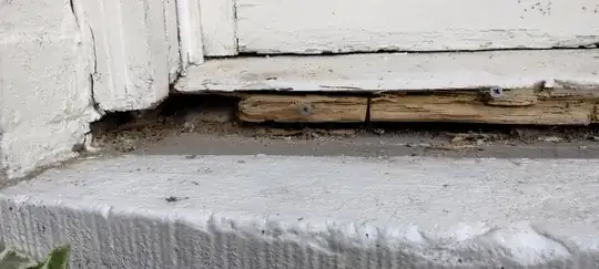

right side of original sill

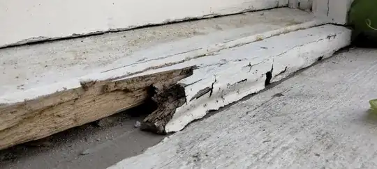

I've substantially removed a little part of the sill on the left side and used an oscillating tool to loosen about 2" deep under the stool for about 8 inches, but the sill refuses to budge. space under left side of stool

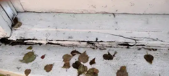

left side under stool, wider angle I drove in some screws in an effort to use a prybar to pull the sill out - to no avail.

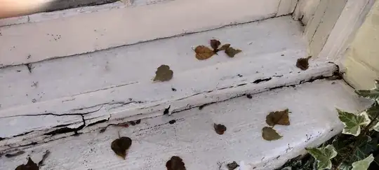

So I just plunge-cut the rest of the front of the sill off with an oscillating tool right side of window, rotted sill portion removed

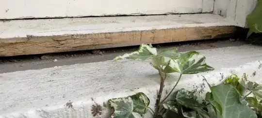

removed portion of right side sill roughly in place The only way I can see to extract the rest of the sill (so the right 90% looks like the 10% or so on the left) is by hacking away with an oscillating tool - very slow going.
I'd be grateful for tips on how to remove the entire sill efficiently, or on how to plane or rout out say 1/2 inch deep of the remaining sill so I can partially slip some new wood under the stool for the repair.

If all that is rotten is what you have cut off, mill a new piece of wood to match the profile and face nail it to the existing sill. Anything else requires removal of the entire window frame to repair properly.
