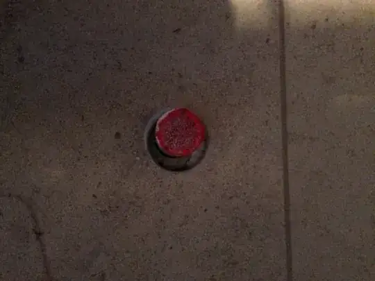

Now here's my issue -- I just don't know how to install it properly. The drain pipe isn't centered with the hole in the floor, it's angled, and I don't know how to patch the area around the pipe. This is what it looks like:

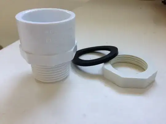

I can drill a hole in the pan in the right spot, but then how should I really make a good seal with the pan? The pan came with a PVC fitting that is not the right size for the pipe, and I'm actually not sure how it's expected to go together. This is what I was given with the pan:
I assume that it's supposed to go in upside down from the way it is in the picture, otherwise the water level in the pan would have to be ridiculously high before it drained. So let's just pretent that the fitting actually fit the drain pipe (it doesn't right now) and I flip it over. It would still sit way too high because the fitting wont go down into the floor since the pipe is off-center!

  • Cut a hole in the drain pan the right diameter to fit over the threaded portion of the fitting
  • Slide over rubber washer
  • Screw on nut

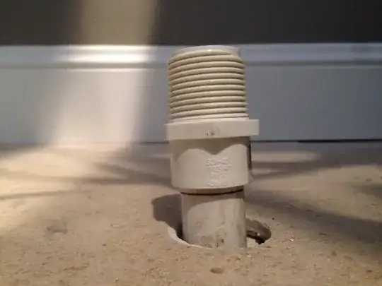

UPDATE -- I picked up a better fitting and attached it to the pipe to see how much needs to be cut:
The bottom of the wrench flats is about 1.5" from the floor, so I imagine that's how much I will need to cut. If I do that, the bottom of the pan will have to bulge up a little where the fitting is, as I'll need to put a rubber gasket ring below the pan since the plastic nut can't screw down all of the way (the thread is tapered). This ends up being about 3/8"... has anyone had issues with their drain pans bulging a little? I guess my main concern is that this means the water will tend to flow away from the drain... but as long as I cut the fitting low enough and it's below the lip of the drain, I should be okay. Perhaps it would be a good idea to cut the wrench flats off and shorten the fitting so that it can be mounted even further below the level of the floor?

Go with your second approach of getting the right size fitting except don't bend the pipe, just deal with the angle. You pan lip should be higher than the ending (with fittings) top of the drain pipe so it can drain but that's all you need.
Why? PVC fumes are extremely toxic and you have a significantly better chance breaking the pipe than fixing the angle; then you'll have to tear up the floor to fix the pipe. A washer machine drain pan is used for worst case scenarios, not day-to-day use so as long as water can drain you'll be fine and a slight angle may actually decrease the minimum height of the drain anyways.

To do it right you need to cut the pipe down below the height of the tile. You can get a Dremel cut off wheel to cut it from the inside to the proper height.
NOTE: you can attach the bit to a drill if you dont have a Dremel.
It looks like the the pipe is too close to the tile so you will have to cut the tile too if you can not straighten out pipe. You would then glue on the fitting so the top of the threaded fitting should be about 3/4 to 1 inch above the tile. Now drill the hole in the pan. Set in place put on gasket and screw on nut. About 1/4" of thread should be showing above nut.
Another less professional approach would be to cut the hole in the pan and let the pipe stick up through. You may need to cut pipe down so it only stick up about 1/2" higher than pan. Then get the most expensive silicone caulk they have at your hardware store and go crazy with it. As log as the washing doesn't shake to violently it should hold. I install sunrooms and the only thing that keep the water out is silicone caulk. Can't be the cheap stuff though.
