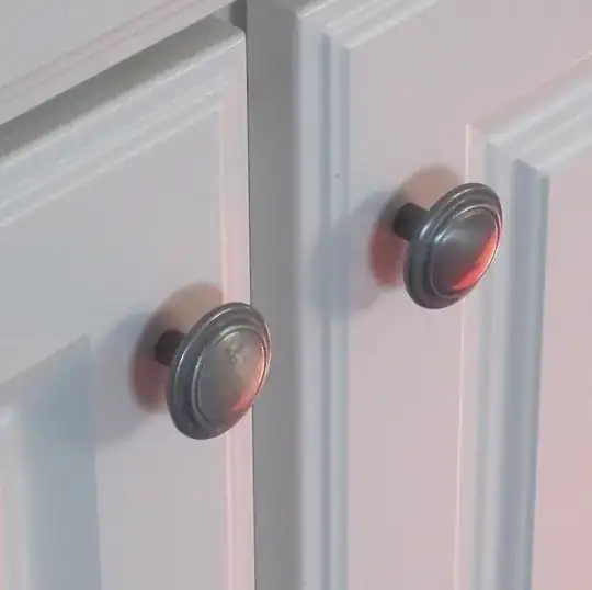

I see knobs like this on cabinets, dressers, and closet doors. They are held in place with a single wood screw. knob
Very often they are loose. I guess when we grab them we often impart a slight twist. Also, temperature and humidity changes cause the wood to swell and shrink. The system is biased towards unscrewing, so over time they loosen up.
My DIY instinct says that this is bad. That the screw will strip out the knob, or it will ream out the hole in the door. Well, it seems sloppy.
When I notice one, I give it a twist to tighten. Sometimes I put my finger over the screw head to hold it still. When it's really stiff, I might get out the multitool. Sometimes, in my enthusiasm, I strip out the knob. Doh!
What's the best way to deal with these things? For example:

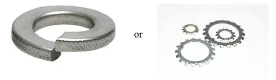

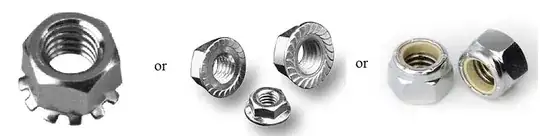

Put a lockwasher between the nut and a regular washer (inside the door). Or use a Locknut and a regular washer. enter image description here enter image description here

Ben Welborn's lock washers are nice. When things get problematic, I move on to Loctite Blue 242 Threadlocker. It's easier to deal with than dried on nail polish or epoxy.
