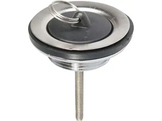

In this product? "OBI univerzális szelep acél 38,5 mm" I've no idea what that "38,5 mm" is referring to. I've no experience also.

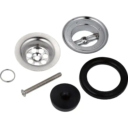

Here are its pictures: OBI Universal Valve Steel 38.5mm with cap OBI Universal Valve Steel 38.5mm components spread out
What's the "38.5mm" about? and maybe also if you know what the size of the bolt/screw is?, in case anyone stumbles upon this trying to find that because their threads are ripped. Also, is this really called a valve? this whole kit? Thanks.
anonmaybe
The 1 1/4" is the thread size for the waste pipe connection.
The 38.5mm is the hole size of the sink or basin it is designed to fit.
