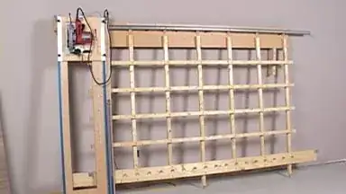

You want a panel saw:
Some are dedicated saws designed for the rig itself. Others are the rig that you can attach your own saw to.

This can also be turned into a poor man's panel saw, by the way: Set up braces to support the panel, attach this guide at the right place, clamp, crosscut or rip. One of the woodworking magazines had a cute set of wall-mounted supports for exactly that purpose in a tips column some time in the past few years.)
