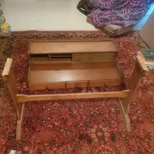

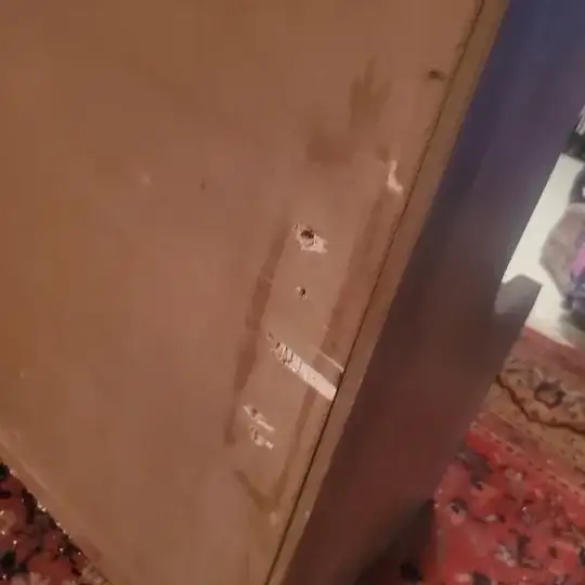

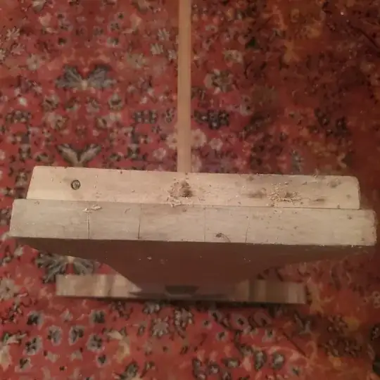

This is a handmade desk of solid wood. The top is screwed to the legs with 6 screws, and the top was ripped off when the desk was dropped while being carried up stairs. How would you repair it so you could reattach the top to the legs? desk in two pieces
holes for screws in bottom of desk
screws in desk legs

I would drill out the torn holes to a suitable diameter - I use 6mm or 10mm (about 5/16" and 3/8").
Then I would glue in wooden dowels, once they have dried then they can have pilot holes drilled to take the screws.
The dowel method can be used to repair the holes in the legs as well as the holes in the desk top.

It's difficult to tell exactly what is and isn't damaged from photos alone. One thing I can tell is that the legs aren't directly screwed into the top. The legs are screwed onto a trapezoid-shaped intermediate block, and then that block is screwed onto the top surface. If the screw holes in that intermediate block are stripped or damaged, I wouldn't even attempt to repair it. I would remove that block and replace it with fresh, undamaged wood. It should not be visible once the desk is reassembled.
The holes in the top are at least a little damaged. If it's not too bad, you may be able to clean up the edges of the holes and use a slightly larger screw plus some wood glue. Threaded inserts are another option that would also make the desk easier to move in the future. Since the top screws into the intermediate block, you might also be able to replace it with a larger block that allows you to relocate the screw holes away from the damaged wood. I see five holes in the top and three screws in the block, which implies that someone already had to do this once in the past.
If the damage is too severe, you may have to replace the bottom panel of the desk. Your photo makes it look like it wouldn't involve too much disassembly, but the details will depend on exactly how the top portion was constructed. If it comes to this, I recommend asking on the Woodworking Stack Exchange site as they will be able to give much more detailed tips.
