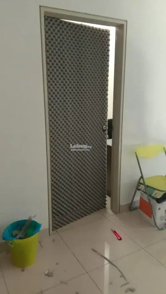

Because filling a hollow core door is difficult and risky (to the door), you could try to add the closed cell foam "egg crate" sound proofing to the inside surface.
