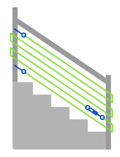

The idea would be something like this:
(Illustration just to show the 'weaving' concept. If I were to do this, I'd route the ends through curved channels so that the cable wasn't attempting to make a full 90 degree turn at any one point.)
However, I never see it done this way. I can't find any examples using just one cable--all cable railings I see use individual cables and attachments for each line.
Question: Is there a reason for this other than perhaps habit/preferred aesthetics? Is there a structural/installation aspect I'm maybe not considering?

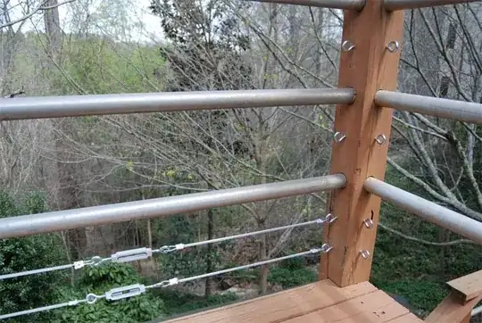

After more web surfing, I came across this blog post where they had the same idea I had--at least in terms of using off-the-shelf hardware:
Note the turnbuckles are almost closed, so even with one turnbuckle per-cable, a lot of slack needs to be taken out to make it taught. MIGHT Be doable with one cable on my short interior run, but anything bigger, I suppose it does make sense to go with one turnbuckle per cable.
That said, I personally think it looks great--but, admittedly, likely best as an outdoor solution on a large deck. It's probably a bit too 'industrial' for my interior short-run.

I dont know how you would make curved channels. But anything short of installing pulleys in the posts I don't think the wires would be tight enough. With the codes 4" maximum opening the wires need to be extremely tight to prevent a child from spreading the wires apart.
Plus the turnbuckle and screw eye contradicts the clean lines of the wire.
Justin K
  • 1,401
Just speculating, but one single cable provides a single point of failure. That fact alone probably excites lawyers enough to prevent such products from being widely produced, let alone marketed.
Also, the friction at the posts will be quite high at the range of tension needed to stabilize the cable making it quite difficult to transmit the tension throughout the array.
With all the cable tension coming from one point, there will have to be quite a bit of cable stretching to compensate for at the turnbuckle. Either it will have to be extra long, or an installation tensioner will be needed to get in the ball park of turnbuckle adjustability.

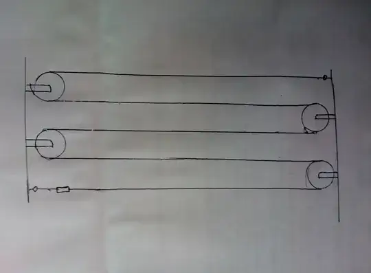

I have it! 4" cable pulleys (used in garage doors)
You put them on the inside, (no post grooving) The 4" diameter means the spacing between strands will be perfect, the tensioning will be uniform, with no kinking.
You just offset the opposite pulleys down by 4".
