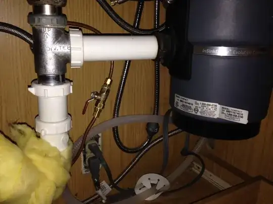

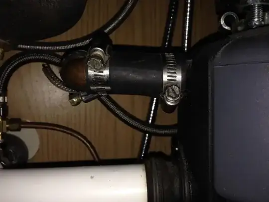

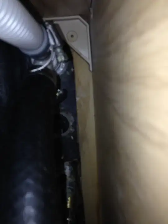

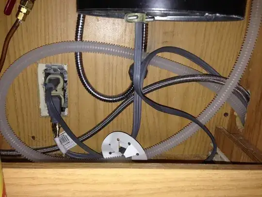

Here are some pictures of the hookup: enter image description here enter image description here enter image description here enter image description here
What should I be doing to fix this terrible odor? Is this a plumbing issue or something wrong with the machine?

Maybe there is a dishwasher defect or installation problem which causes some discharge to leak onto the floor or inside the dishwasher: When the accumulated debris is freshly leaked upon, the odor is diluted. But once it dries somewhat it resumes rotting.
Look carefully at the drain hose to the garbage disposal, its drain, trap, and associated plumbing. Feel for any moisture under the sink where the water and drain connections are. If installed properly, there should be absolutely no moisture under the sink nor under or near the dishwasher.
If you can't find a problem under the sink, turn off the d/w circuit breaker, remove the access panel at the bottom of the dishwasher, shine a bright light under there, and feel around. It should also be perfectly dry.

Assuming (as with most) the dishwasher is connected to your kitchen sink drain, I suspect that you're smelling what the inside of your kitchen sink pipe smells like, which is a combination of rotting food and soap residues. It's a distinct smell from sewage, more like a sour/pungent smell than sewage.
If it is a sour/pungent smell, I would check whether the dishwasher drain hose is run properly. It should curve all the way up to the height of the counter (as close to top of sink as possible) before running down to connect to the sink drain. If it does not, you may be back-flowing into the dishwasher or allowing the smell to escape once the water inside the dishwasher evaporates.
If it is a sewage (think driving near a sewage plant) smell, verify that your dishwasher drain hose is connected before the P-trap (as suggested by @Edwin), rather than after, as it again may be allowing the sewer gas to escape once the water has evaporated.
