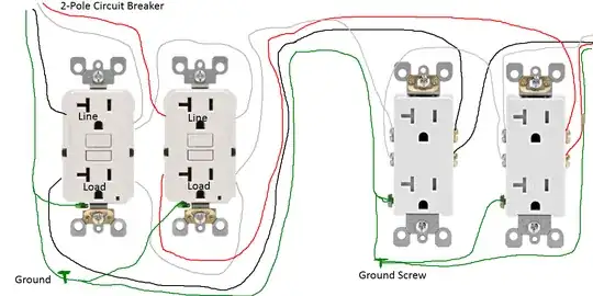

I'm trying to wire two GFCI circuits sharing a neutral. The line is coming in from a 2-pole circuit breaker. I want to have two circuits at each location, each protected by a GFCI upstream.
Currently, I have it wired as shown below. If I reset 1 GFCI outlet, it works. When I try to reset both GFCIs, the first one trips.
What am I doing wrong?
