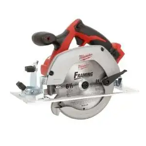

For long cuts along the length of a board, the best tool is a table saw. And the second best would be a circular saw with a jig. If you don't have plans for more projects like this, or simply need to save space, then the circular saw makes more sense. Setup a jig with a long straight edge that you can run your saw along and clamp it on top of your boards to be cut.
circular saw example jig
