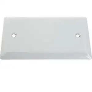

Why not use a simple blank electrical box cover?
blank cover
They also come in round versions (about 5 inches) to cover electrical ceiling boxes.

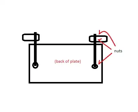

You could hold it up using thin bolts through the eyelets with nuts locking on a small offset piece of plastic on each end that could rotate outward above the drywall to hold it in place.
cover holder
