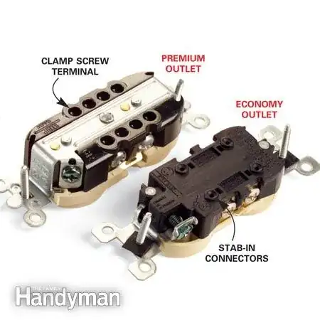

Besides an arcing switch, there are 2 other common 'loose wire' scenarios to consider.
  1. Loose wire wrapped around a side screw terminal. Turn off the breaker and tighten the screw. The wire should wrap under the screw head nearly 360 degrees (clock-wise). The insulation should cover the wire to within 1/8 inch or less.
  2. 'Back stab' connections are notorious for arcing connections. I cut them off (if there is sufficient spare wire and side wire them. The 2 round holes (in the right device) are the Quickwire connections (to be avoided) Much better are 'screw and clamp' devices that allow 2 secure connections per terminal (left device in photo) enter image description here
