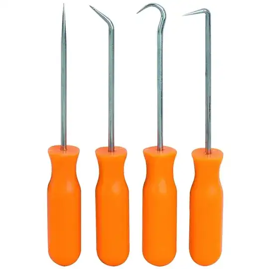

try a pick?
a pick
(source: harborfreight.com)
can be gotten at any hardware store, i know this works with schlage keys, done it many times at an ice rink with people breaking keys
if you get it out get a new key and lube it with powdered graphite
