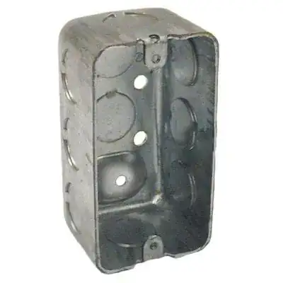

Don't waste your time pulling sheathed NM in metal conduit, it's hard, annoying and unnecessary, and will make it difficult to pull other wires later. To make a transition from conduit to NM, run conduit away from the service panel out to a quality steel box, run THHN (hot and neutral) to the box, then bring the NM into knockouts in the steel box with approved clamps. The steel box should have a bump with a hole tapped 10-32, for a ground screw. It's stylish to use little green screws. Come off that screw with a solid-core green or bare wire, and wirenut it to your ground wires. Here is a box with the bump, it is $1.
