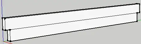

I am trying to join a 2x4 supporting a workbench tabletop to another to make a backsplash of sorts. Any ideas how to do this without dowels? (No, I can't use 2x8)
Example

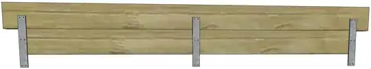

Strapping
You could use some form of strapping on the back side.
Strapping
With this option, you can extend the strapping and use it to attach the whole bit to the workbench.

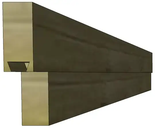

Sliding Dovetail
If you want to get real fancy, a sliding dovetail would work.
Sliding Dovetail
Though with this joint, you'll loose a bit of overall height.
