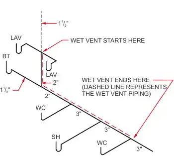

The image below, taken from this plumbing code page, has an "SH" going to the middle pipe with the trap in it. Does anyone know what the "SH" stands for, or the "BT" and "WC" ones for that matter?
code image
The reason I ask is it seems to match the layout of some roughed in pipes coming out of my basement floor I asked about here. I thought maybe knowing this will help me confirm what I have.

Shamefully stolen from ArchToolbox's webpage of Plumbing and Fire Protection Abbreviations.
This is a link to that page.
... found by using google to search for these 6 terms: wc sh lav bt plumbing acronyms.
This is a link to that google search.
AP    Access Panel                    HW    Hot Water
BT    Bath Tub                        HWR   Hot Water Return
BWV   Back Water Valve                HWS   Hot Water Supply
CFH   Cubic Feet per Hour             ID    Inside Diameter
CFM   Cubic Feet per Minute           INV   Invert
CI    Cast Iron                       IW    Indirect Waste
CLDI  Cement Lined Ductile Iron       MECH  Mechanical
CO    Cleanout                        MSB   Mop Service Basin
CONC  Concrete                        NC    Normally Closed
CP    Chrome Plated                   NO    Normally Open
CTE   Connect to Existing             OD    Outside Diameter
CW    Cold Water                      OED   Open End Drain
CWR   Cold Water Return               PIV   Post Indicator Valve
CWS   Cold Water Supply               PLBG  Plumbing
DCVA  Double Check Valve Assembly     PSI   Pounds per Square Inch
DF    Drinking Fountain               RPBP  Reduced Pressure Backflow Preventer
DIA   Diameter                        SA    Shock Absorber
EL    Elevation                       SH    Shower
ELEV  Elevation                       SHWR  Shower
EWC   Electrical Water Cooler         SK    Sink
FCO   Floor Cleanout                  SS    Soil Stack, Stainless Steel
FEC   Fire Extinguisher Cabinet       TLT   Toilet
FHV   Fire Hose Valve                 TS    Tamper Switch
FLR   Floor                           TW    Tempered Water
FP    Fire Protection                 TYP   Typical
FS    Flow Switch                     U     Urinal
FT    Foot or Feet                    V     Vent
FV    Flush Valve                     VB    Vacuum Breaker
GALV  Galvanized                      VS    Vent Stack
GI    Grease Interceptor              VTR   Vent Through Roof
GPF   Gallons per Flush               W     Waste
GPM   Gallons per Minute              WC    Water Closet (Toilet)
HC    Handicapped                     WS    Waste Stack
