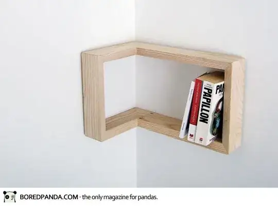

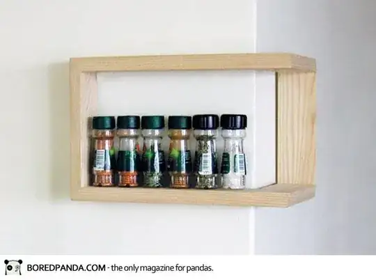

I would like to make some bookshelves similar to what is seen here:
Shelf 1 Shelf 2
My question is how to nicely mount these to the wall. Obviously I could simply angle some screws into the wall studs, however I think that'd look a bit messy and would like to hide the mounting method.
