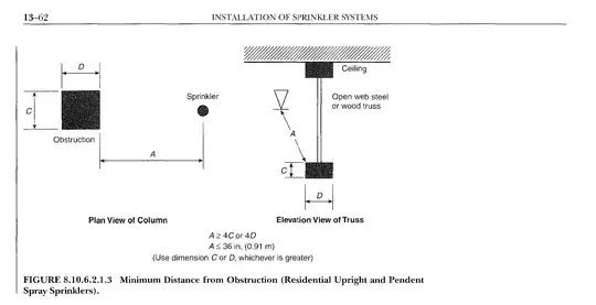

Since you are in a residential occupancy, you will have residential-type sprinkler heads fit, which means that NFPA 13, section 8.10.6.2.1.3 (or the equivalent citation in NFPA 13R or NFPA 13D) applies:
8.10.6.2.1.3* Unless the requirements of 8.10.6.2.1.4 through 8.1 0.6.2.1.9 are met, sprinklers shall be positioned away from obstructions a minimum distance of four times the maximum dimension of the obstruction (e.g., truss webs and chords, pipe, columns, and fixtures). The maximum clear distance required shall be 36 in. (0.91 m) in accordance with Figure 8.10.6.2.1.3.
NFPA 13 Figure 8.10.6.2.1.3
