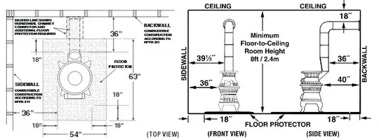

So, returning to the manual for this stove, we find:
The stove must be placed on solid concrete, solid masonry, or when installed on a combustible floor a solid surface floor protector listed to UL1618 Type 2 with a minimum of 1" thick and a R-value of 3.0 or greater, such as Hy-C or Imperial Model UL 5463BK must be used.
(NOTE: To calculate R-values of equivalent alternative materials, see page 15).
The base must extend at least 18" beyond the front, rear and sides of the stove, and must extend underneath and 2" beyond each side of horizontal connector pipe if it is elbowed towards a wall (see figure 5 and consult local building codes and fire protection ordinances.

If you decide to DIY your floor protector, it basically has to be usable as an open hearth (resist 2 hour burn) and consists of a 2" thick firebrick platform overlaid with 24ga. min thickness sheet steel that extends out 18" from all sides of the stove. It also has to extend under the pipe to the wall.
