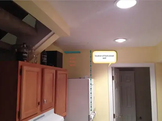

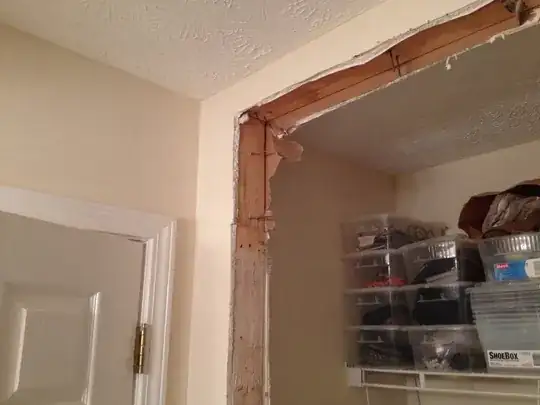

I've removed the door/frame and need to know how much more I can safely remove. Is what I'm looking at just there to frame the door? I am 99.99 percent certain the rear wall of the closet is load bearing; the ceiling joists run perpendicular to the wall(s)
On the left, I'd like to take that down as close to the wall as possible. This is the side the washer/dryer will go.

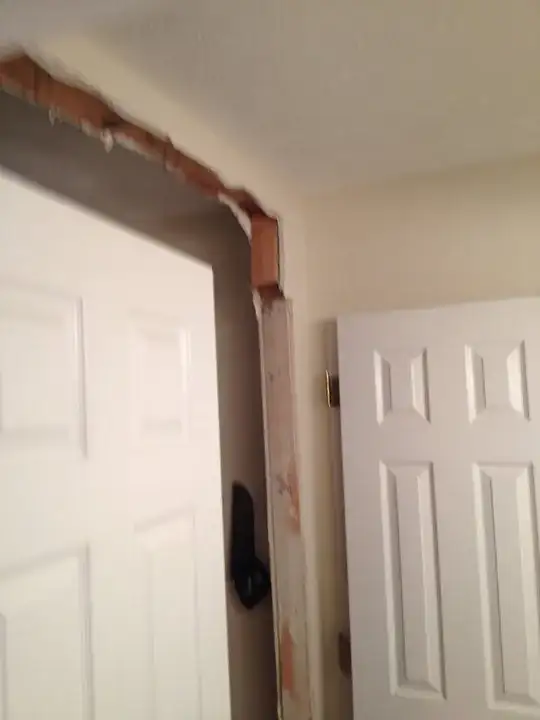

bad image of the other side. enter image description here
the other side of the wall. enter image description here

Probably not load bearing. Looks like roof load is on closet back wall (is that an exterior wall)? To be doubly sure, I always go to attic and look to see if there's any roof trussing sitting on top of the wall you're removing. Measure downstairs for landmarks (for reference points) when you're up there. Good luck, demo is FUN!
