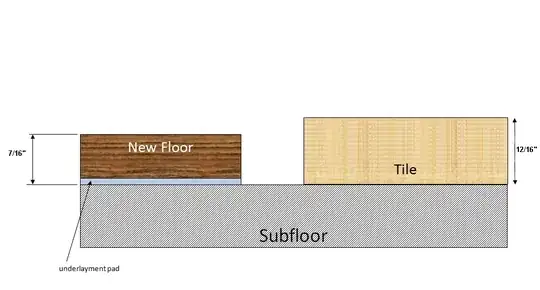

I am laying my floor but I have a transition that I need help with, I am going from laminate to tile but the tile is much bigger. I have attached a drawing of the 2 different materials and I am looking to see what people might recommend on doing

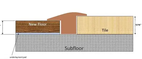

The transition problem that you depict is often solved with a trim strip made of wood that can look something like as shown below. It is often possible to purchase a similar molding and re-saw it into necessary shape. However your could also make your own from a length of the appropriate hardwood using a combination of a table saw and a router table.
