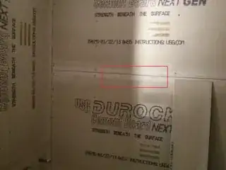

This is around a tub/shower. The studs are spaced at 24in, cement board is 1/2in.
We're surprised at how much flex there is between the sheets of cement board. I'm worried that tiles may pop off.
We're planning to use 12in floor tiles on the wall.
Some options I've considered:
  • Leave it. It's fine.
  • Aim the tile grout lines at the seams of the cement board. Flex won't affect whole tiles.
  • Add blocking behind the seam. PITA.
  • Add another layer of cement board, maybe 1/4", shifted over so the seams don't overlap.
What should I do? If anything.

What about adding 1/4" backer to 1/2" for firmness - Looks like a solution? The tub has been installed so another stud can't be added.

Since they're up, I agree adding blocking is a PITA.
However, if its an inside wall that you have access to the other side of, use a "BIG GAP" polyurethane foam. Drill a series of 1/4" holes every 12" down the middle of each joist bay. Spray a 3 sec burst in each. Wait 12 hr and try the flex, it should be quite firm now.
You may not want to do this near the plumbing valve, for replacement purposes. It won't hurt it, though.

In addition to optionally reinforcing the backer board with more studs or cross pieces where the seams will be, you should definitely fill the seams with either mud or grout. In my bathroom I went with mud, but not the stuff you buy pre-mixed. The stuff you mix yourself, IMO, sets up much more firmly.

Sheet the wall with membrane like Kerdi (Schluter product) or Noble Flex. It will tend to 'unitize' the wall (by spanning multiple pieces of cement board). Be sure to embed with a portland cement based thin set mortar.
As an added benefit, it will completely waterproof the wall.
Its a bit belt-and-suspenders, but I like my shower walls DRY.
