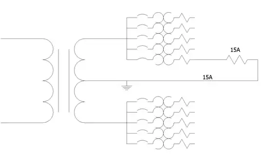

Single Load
With a single branch circuit supplying a 15 ampere load, we see that there will be 15 amperes on the grounded (neutral) conductor. This is fine, since the grounded (neutral), and ungrounded (hot) conductors are both sized to carry 15 amperes.

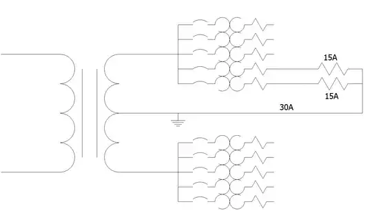

Two loads on the same branch circuit
Two loads
In this situation, we'll see 30 amperes on the grounded (neutral). However, since we're also drawing 30 amperes through a single breaker with 15 ampere overcurrent protection, the breaker will open.

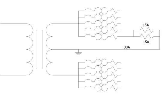

Two loads on the same leg, but different breakers
same leg, different breakers
This is the dangerous situation, since the breakers will not trip. Each circuit will draw 15 amperes on the ungrounded (hot) conductor, but the grounded (neutral) conductor will see 30 amperes. Since the conductor is only rated for 15 amperes, the conductor is in danger of overheating and starting a fire.

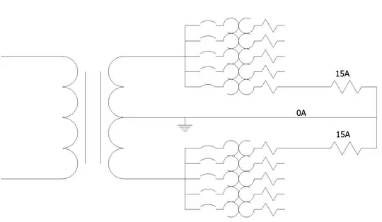

Two loads on different legs
Different legs
If the two loads are on different legs. You'll find that while each ungrounded (hot) conductor sees 15 amperes, the grounded (neutral) carries 0 amperes.
