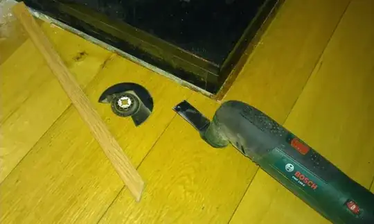

A multitool was exactly what was needed. Thanks to @bib for the suggestion. Ended up getting this Bosch multitool as it had both the half circle and straight blade.
Chanel cut in floor

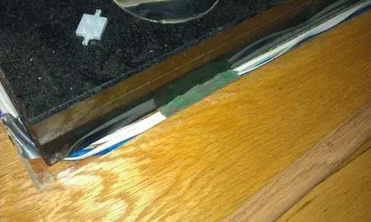

I cut though the floorboards with the tool - it took a little longer than expected but it worked perfectly.
Ended up with quite a deep groove and had loads of space for the cables so managed to fit 2 network cables, 2 TV cables and a phone cable. Might also run some speaker cables while I'm at it.
Also, there was no problem running the cables around the corners as there was some space under the corner of the hearth.
To hold the cables in place, I used some old play doh and it worked perfectly.
play doh holding cables in place
