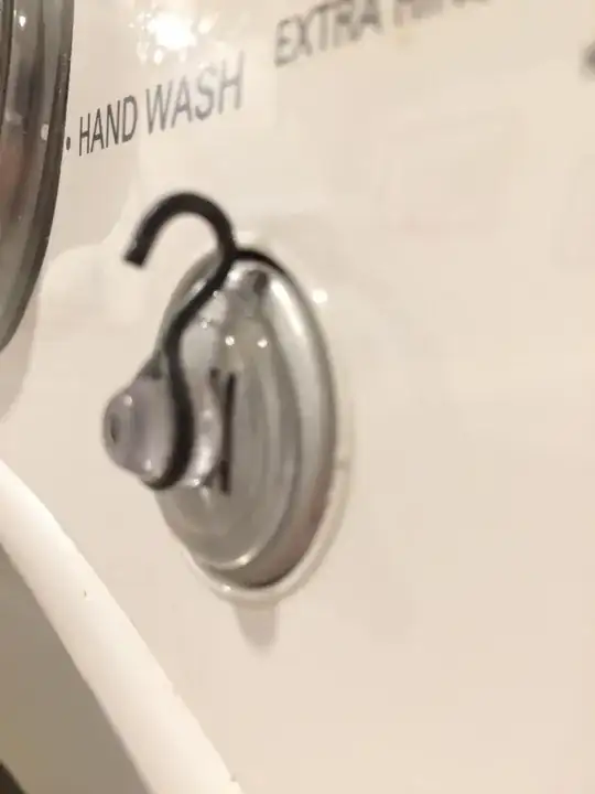

I used a dollar store suction cup.
As I was pressing it to adhere, the washer turned on.
It is staying affixed for now.

My LG start button was stuck in and would not press to turn on. There was no "give" to the start button when pressed. I used my kids toy arrow with a suction cup on one end. Wet it and placed it over the start button. Pushed in so the suction was activated. When I pulled the arrow off, the button pulled back out to the correct position, no longer stuck in and was able to start the washer when pressed. Cost: Zero
As suggested by one commenter, I used a small 18 gauge brad nail in the hollow end of the back of the button, cut to size so it was just slightly over the edge of the tube. It worked; let's see how it holds up.
