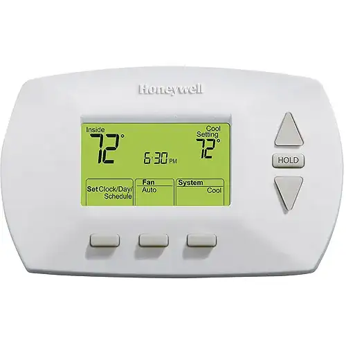

Even the cheapest digital thermostats have schedules, so that they can have different heating points during the morning, daytime, evening and overnight, and range from having weekend vs weekday to 7-day indepedent schedules. This allows you to save money by turning down the temperature while you're not home or sleeping.
typical digital thermostat

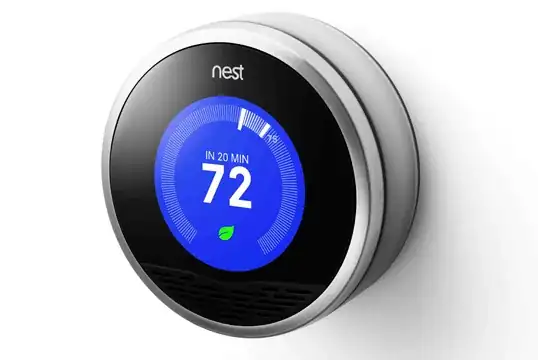

On the more advanced side of things, there are internet-connected thermostats you can program/control from your PC/phone/etc, and ones that can self-learn based on manual adjustments and motion-sensing. There is a corresponding increase in price, and these typically do require a C-wire so since you only have two wires you'd have to pull a new wire for this.
NEST thermostat
To connect a basic digital thermostat to the 2-wires, the best thing is to follow the instructions that come with the thermostat. Typically you're going to connect the two wires between R (or Rh) and W.
