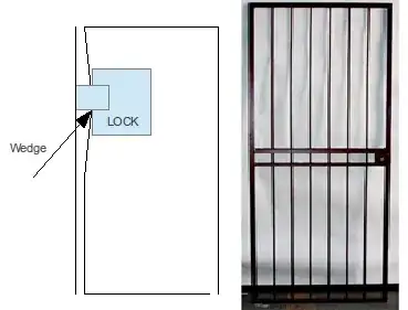

Funny Enough!...In most situations it would be much faster to break the lock (or at least force the gate open), rather than actually spending time picking the lock. This changes the times to seconds not minutes!.. I have made a very ugly example to illustrate.
In many cases the frame of the gate is has enough torsion/flexibility, that applying a wedge between the outer frame and inner frame (ie the gap where the lock pin goes into the door frame) and opening the gap will simply "Jimmy" the lock open.
The Right hand picture shows a typical prevention of this where lateral support is added in to improve the lateral strength of the gate frame (provided the end opposite to the lock is butted against the other end of the frame.
