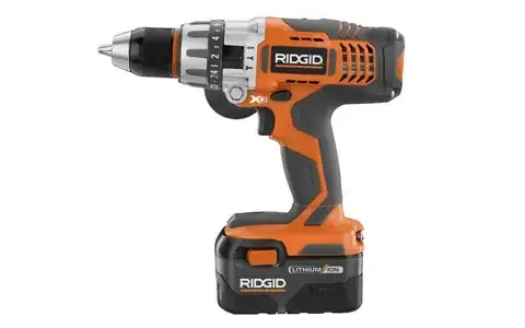

Hammer Drill
The job will be much easier with a hammer drill, or a drill with a hammer option. Though it can be done using a regular drill, given enough time and patience.

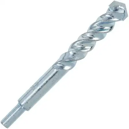

You don't have to have a hammer drill to drill masonry. The hammering process helps the bit not get stuck as readily, but they do make masonry bits for regular drills as well. Note the double-flute of this one, compared to the one Tester posted. I think Vermont American might be the only brand to make these (I've not seen any other brand for standard rotary)

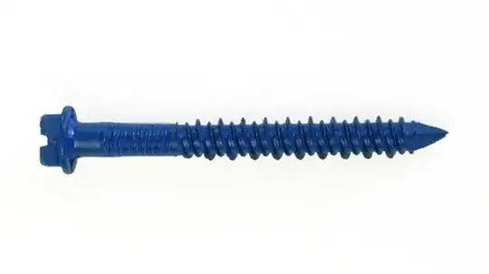

I would highly recommend the Tapcon brand for regular mounting. They have a special screw for masonry that requires no anchors.
They also have specific sizes matched to the masonry bits they sell, so there's no guesswork in what size bit you'll need. I've been able to mount a wide variety of things to my brick siding using these and nothing else.
