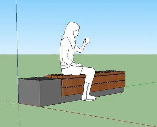

How can I attach wood to concrete in this bench?

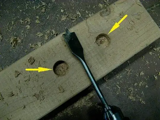

  1. Bolts, concrete fixing bolts, recessed, optionally plugged.

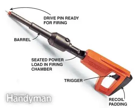

If you want to have some fun, you could also go with a powder actuated hammer:
It's essentially a gun that will shoot a nail into the concrete. Works great. Would be super-fast (no pre-drilling). But likely the least accurate option. You'd also be left with the nail heads/washers to deal with.
