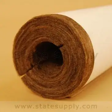

To echo what @acrosman said, yes insulate the pipes. I'd suggest using fiberglass pipe insulation joined with foil tape, and loose fiberglass / PVC caps for turns. Wear a respirator. Cuts can be made with a sharp, long utility knife.
here's an example:
example
