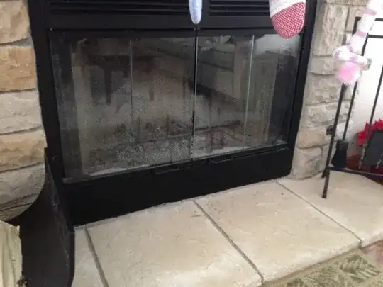

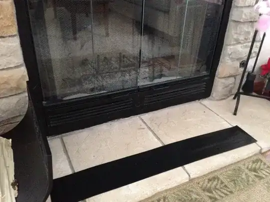

Similar to @BMitch's answer, I used a magnetic cover to cover the vent below my fireplace. We found this was the primary cool air leak for our fireplace and I bet it is yours too. It works great, and is very simple to remove before starting a fire. Since it is black like the fireplace, it is not even noticed. I bought one from this site selling the exact size I needed and in black.
With magnet on magnet removed and sitting in front
Here is my fireplace with it on and removed.

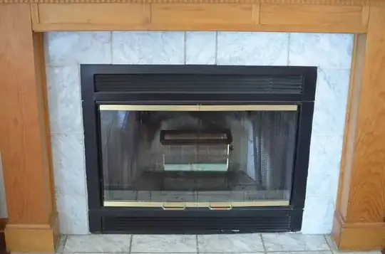

If the worst part of the draft is coming from the vents above and below your insert, you can block the draft with some magnetic vent covers:
Test the your insert first with a magnet to make sure these covers will stick.
