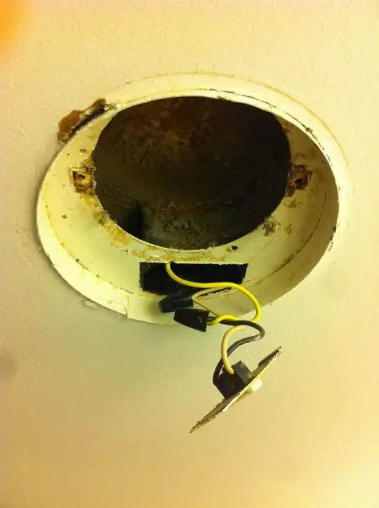

I've read Replacing a bathroom fan and Where can I find a bathroom fan that will fit in a 5" cylindrical space?. I decided that I would replace my Ventra bath fan with an Air King. The Ventra unit is 8" in diameter, and the Air King is 8.5" x 9" (without exhausts). The problem that I'm having is that I can't find how the Ventra unit is mounted:
I'm able to wiggle it on the right side, but the left won't budge. My attic space is not accessible over this area, should I just cut the dry wall around the unit? Any other suggestions or advice is appreciated.

The casing is more than likely nailed or screwed to the ceiling joist on the side that does not move. It may be possible to open a small slot along the face of the joist. Then run a reciprocating saw (Sawzall) along the face of the joist, eventually cutting the attachment fasteners and freeing the casing.
The risk here is you could damage other things attached to the joist, such as wiring. If that happens, you'll need to do the alternative approach. Partly to access the fasteners and partly to repair the damage.
The alternative approach is cut out a big enough panel in the ceiling to give you room to work and remove the fasteners anchoring the casing. Patching the hole isn't too much work, though matching the texture finish can be tricky. You may have to settle for a less than perfect match.
