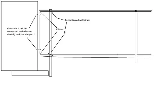

I had the same situation at my place, I set the post and ran the top rail past it to the house and set elbows to make a hoop to carry the chain link past the post. I did not want to screw anything to the house so I rebent wall brackets to clamp the top and bottom rails to the line postDog pen
