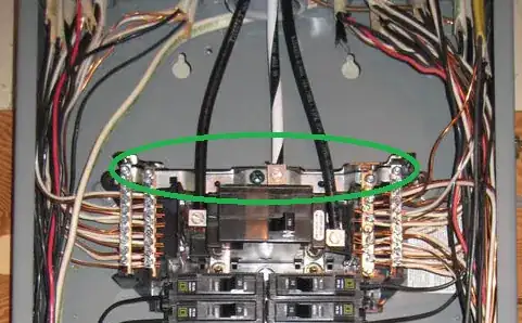

If this panel serves as the main disconnect, and the grounding and neutral bus bars are bonded. Then yes, you can terminate both grounded (neutral) and grounding conductors at the same bus bar.
Notice that the bus bars are bonded using a bonding strap.
