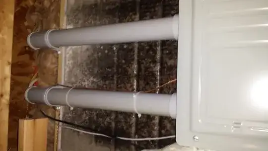

After 2 years we had mold behind the blanket on our North wall that is above grade.enter image description here
