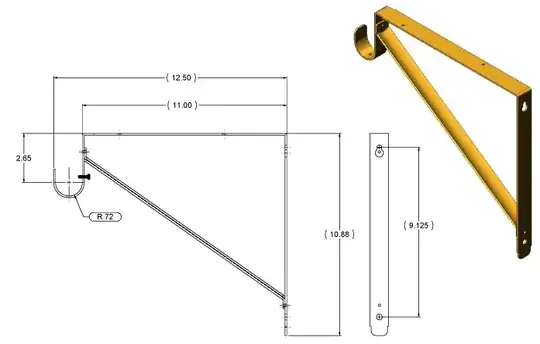

The standard is 67" up to the top of a 1X4 ledger and 12" from drywall for single hanging. the centerline of the closet pole cup is typically is 2" from the top of the ledger, it can be lower, then the ledger needs to be wider to accommodate. That puts the shelf at 67 3/4" to the top. The 11 1/4" shelf will give the room needed to get the hanger on. This is what I learned 40 years ago from my then 60 year old mentor. But there is nobody waiting with a hammer, if is varies. My mentor would have waited though. If the closet is shallower than 24" you can reduce it to the center of the closet as close as 10" as Testor101 suggests. The dimension to the back of the door give a little room for this to work if need be.
For double hanging to keep clothing from dragging severely over the lower setting and on the floor, 42" and 84", I learned this from my own closet at home. If it is a child's room these can be varied too, say down to 40" and 80".
When planning how it will go together, have your center support bracket on hand that you plan to use. Some manufacturers make the seat that the pole sets in different heights. I have seen brackets that are only have 1 1/2" to the center of the pole as opposed to the one in the illustration above that shows 2 5/8" more or less. The former will need a 1X backer at the top were the latter will not. Most center brackets are gauged to use a 1X on the wall to get the back of the bracket in the same plane as the ledger.
