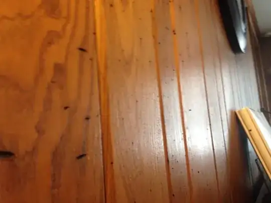

The problem is that there aren't any studs (at least none that I can find) behind my wood walls. My walls are not wood paneling; they're solid tongue-in-groove wood (see picture).
The only structure I can find behind the walls is a few horizontal bars of wood at intervals. The wood walls are nailed into these horizontal braces. The intervals are too widely spaced for me to get all mounting bracket screws into them. I could get either the top or bottom mounting screws into them, but not both.
Given that the walls are wood (not just paneling), do you think they would be able to bear a 52lb TV mounted to it? If not, how should I safely mount my TV given my lack of studs?

If you use decent screws, you should have no problem mounting right to the surface wood, without worrying about where you are behind it. It's a much more robust material than drywall, and 52 lbs is not all that heavy. You could certainly line up the top bracket screws with a strap and use longer screws there, but you probably don't need to.
This answer is way too late - I just saw the post now. One look at that and I'm sure you live in Hawaii. That wall is Single Wall Construction. Your're right about it being tongue in groove. It's probably 3/4" redwood. I would NOT put screws into that. The wood is too soft and will probably not hold. I would actually bolt it on. Understand that you will be able to see it clearly from the other side of the wall. So it matters what's behind the wall. I think the only other way is to actually build another wall in front of that one. People do this but it would be a lot of work and expense if your only goal is to mount a TV.

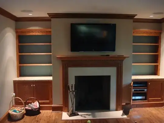

If your mantel projection is sufficient, it will protect the TV. Mine is set above the woodburning fireplace, it was cranking out the heat after a couple of hours burning red oak, it was not getting the TV hot at all. It is a zero clearance prefab Heatolator brand I installed myself, the mantel has a 8 1/2" projection at the top, with the TV 5" above to the bottom edge and the top of the mantel is 16" above the firebox top. Although everything gets really hot, yes, but there is a "wall" of cooler air entering the firebox from the room at the same top edge. That makes the front of the box cooler than the front.enter image description here
