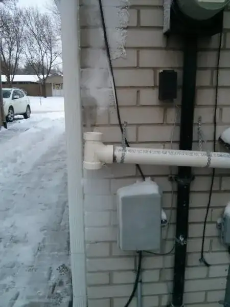

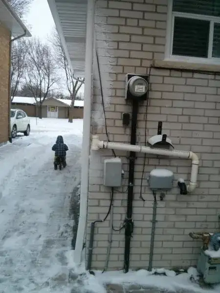

is my high efficiency furnace vent installed properly? I'm based in Toronto, Canada. In some recent cold winter weather, the exhaust is causing a lot of ice buildup on the surrounding brick. To my limited knowledge, lots of freeze / thaw cycles for brick is a bad thing, which can cause brick to deteriorate rapidly. So is this an issue? If so, is it worth correcting and are there any easy DIY solutions that you would recommend?
Could I change the venting to just be one vent, instead of two (right now the exhaust vents both up and down)? And maybe aim the exhaust a bit further from the brick?

I am a Local HVAC Tech in the Toronto area. As stated, this exhaust is not installed according to local codes and the manufacturers installation instructions. There is no surprise that you are getting freezing condensation on the brick of the house. The reason for having the vent terminate straight out and away from the building is to avoid this. The facing of the brick will chip off after a few years of this. Another issue i see is that any exhaust for a high efficiency gas appliance must be insulated when being run in an unconditioned space (such as in a garage or running under a deck). Now if the termination is 2ft or less, you do not need to insulate the exhaust. However, in your situation there is a long termination, which requires it being insulated to prevent freezing.
My solution would be to cut off the tee at the end of the termination, slide on armaflex pipe insulation around the exhaust. You should have from where the tee started, to where the pipe enters the house fully insulated. Then using system 636 PVC glue and primer if doing it in cold weather, glue a system 636 PVC elbow onto the end of the termination so that it is blowing the exhaust straight away from the house. Then cut a 6" piece of system 636 2" PVC pipe and glue that into the elbow to help throw the exhaust further away from the structure. Doing all of the above would solve all the termination issues, and bring it back up to code.

The exhaust pipe discharge is too close to the house. It should extend 8 to 12 inches from the wall if using tee on vent end. The exhaust might have been placed in its odd position because of a gas regulator vent. I see the pipe exits near the gas service. From a survey of high efficiency furnace installation manuals, and my own experience installing my furnace, the exhaust vent termination must meet the following conditions (although the installation instructions may vary):
  1. Be at least 6 inches from operational window openings
  2. Be at least 3 feet horizontally from service regulator vents, extending 15 feet vertically (Applies to Canada, not US.)
  3. Extend 8 to 12 inches from walls if using tee vent. (This doesn't seem to apply if venting perpendicular to wall).
  4. Be at least 3 inches in the horizontal and 12 inches in the vertical from the intake pipe
  5. Be at least 12 inches off the ground or anticipated snow level (if applicable , definitely applies in Canada).
The tee at the end is optional unless your instruction manual says otherwise.
Although there is a limit on the number of 90 degree turns you're allowed to put in the vent, in your case, I'd cut off the tee and put an elbow that directs outward from the wall.
You must make sure that you maintain the slope so that the condensate drains back to the furnace.

There are two things you need to look at to get an answer.
  1. Local Building Code
  2. Manufacturer's installation manual
Both of those will probably address how far away from a window or door and how far away from certain building materials the exhaust vent must be. So make a phone call to your local code authority and find the installation manual for your furnace.
The manufacturer installation manual will dictate the maximum length of the exhaust vent. It will also dictate things like slope and end treatment of the exhaust.

You'll probably have to maintain the Tee exit - it serves a couple of purposes - harder to block, and less prone to backdraft. Should be able to move it a bit further from the building.
That installation looks dubious (to me) as it stands in part due to the vent-end proximity to the window. Different codes in different places - the gas meter right next to the electric would not fly here, either - 10 foot minimum. Obviously that's OK with the Gas and Electric services in Toronto.
This is not only a poor install but it is against gas codes. You cant have combustion air vented into your appliance within 4 meters of your gas meter. If there is ever a leak, and you're burner is on, you're appliance becomes a bomb. I would have this looked at. Sorry man.
Wow, everything looks wrong. The contractor that built your house needs to read a little book called "uniform building code."
  1. Like you noticed, your HVAC vent is wrong. Cut off all that PVC on the wall and install a vent/intake box.
  2. Your gas and electric are too close, UBC says your natural gas vent should be no less than 3 feet from electric service.
  3. There are no poles or "bollards" protecting your gas meter.
  4. I could keep going...
