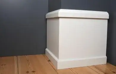

I am not a carpenter (programmer actually), therefore I need to know if it is possible to conceal wires in a baseboard. Basically I want a combination of this

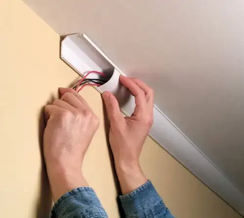

And this
But I don't want my entire house to look hideous.
If it is possible, are there any off the shelf baseboards, or do I have to get a carpenter to custom make them?

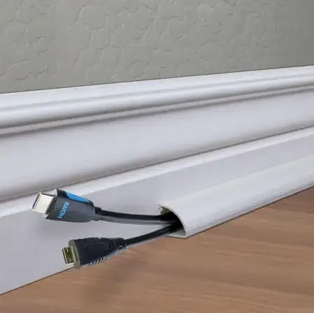

There is channel that you can run along the baseboard in place of the quarter round molding. You paint to to match the baseboard or the quarter round (even cover it with wood-look contact paper) and it isn't noticeable. Here's an example: Qtr Round Baseboard Channel
Lots of variations on the idea: http://www.homedepot.com/s/channel+raceway?NCNI-5
