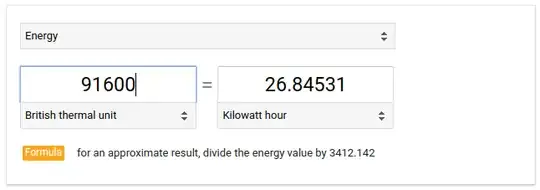

In your case, electricity appears to be a much cheaper source of heat than propane.
A gallon of propane yields 91,600 BTUs of heat. Google can convert that for you:
https://www.google.com/search?q=91600+btus+in+kwh
BTUs vs. kWh
So with propane costing you $5.10 / gallon, the same heat from electric is costing you 26.84531 * $0.08 or $2.15 - less than half the price.
