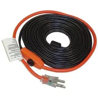

You might want to consider trace heating, using heating cable.
There are lots of different brands available with built-in and add-on thermostats, plug attached or hardwired. Simply install the cable following the manufacturers instructions, set the thermostat, and stop worrying about frozen pipes. Most cables are designed to work with both metal and plastic pipes, so it's a fairly versatile solution.
