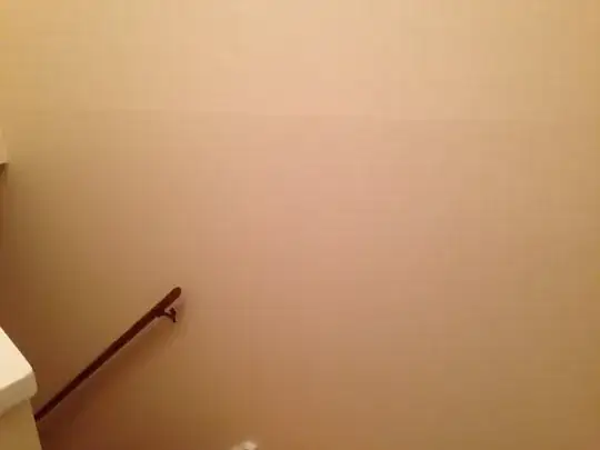

Also, in the stairwell in my home there is a very distinct line, where the 2 pieces of drywall on top of each other meet. Is there anything that can be done to minimize that line as well? (image below)

You will need to smooth it out by applying increasingly wide applications of drywall mud; depending on how rough it is it might take 2-3 coats. You would then sand it smooth, prime and repaint the entire surface.
Unless the drywall is water damaged or has significant physical damage (doesn't look like the case), you will not have to cut out anything.
On the ceiling you might be able to get away with just repainting the entire ceiling (prime first!) as people are unlikely to get close enough to it to really notice a few imperfections. I suspect it is more noticeable in your case because of the color difference due to the paint fading at different rates.

The wall looks like a paper joint as well, but in this case, there doesn't appear to be any mud backing the tape up.
If this joint is soft, and can be pushed in - you will need to cut all of the loose tape out, as well as any loose pieces of sheet rock, then re-tape the joint, with fiberglass tape - feathering out into both pieces, far enough make both pieces appear as one.
In both cases, several thin coats, can go a long way, in making the repairs easier to sand and paint. Don't try to get it done all in one day either. In some cases, even a small patch job, can take two or three days, just waiting for the mud to dry, especially on exterior walls and ceilings.
