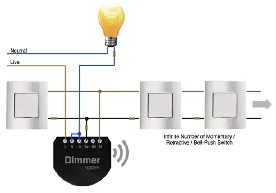

You cannot have a dimmer circut using two dimmers, HOWEVER, i do believe that you can find a solution.
The first is to use a wireless dimmer, with two transceivers.
The other is to wire the correct Dimmer on one switch, the dimmer type must be the bell press button type and not the rheostat type with the knob. These dimmers use a low current circut to determine the dimmer factor (as you press the button, the dimmer will cycle between dimming and full light) You could then simply wire the second switch to the first switch's dimmer circuit (the same way the first one is setup)
LED lights cannot really dim, the dim effect that you get is actually a switching circuit which turns the light off and on really quickly, the dimmer the light, the longer the time that the led is momentarily off for... Each light manufacturer will ahve a list of dimmer types (trailing edge and leading edge) as well as manufacturers which are approved to work as a dimmer... make sure you buy a compatible dimmer module for your lights.
see the image below. enter image description here
