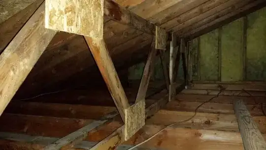

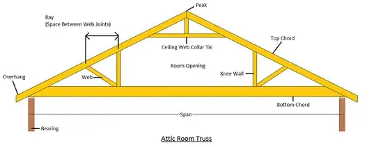

Your best/most cost-effective approach would probably be to convert rafters and joists into a truss system by adding web elements between the rafters and joists. You'll need a structural engineer, but it's the least added material. My trusses spanning 24 feet are all 2x4 material, so it should not take much to make a 2x8 lower chord carry a reasonable load without support from below. So you'll spend some money on engineering and save a good deal in getting it done, while having some peace of mind. Storage truss

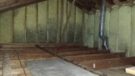

The Engineer may be able to give the details for a top truss run perpendicular to the existing joists. Gravity can't tell the difference between top and bottom. A top truss or beam will create a lump or ridge on the attic storage floor. The 2x8 joists would be held up with strap hangers. The two ends of the truss must be supported, which could be difficult if there's a two car garage door. You'd need to remove siding to slide the beam in place.
Or as @Ecnerwal wrote the engineer may prefer to retrofit the existing peaked roof into a series of trusses by adding web elements. These might go in very easily from the inside.
Family Handyman has an article that has a good analogous bottom support example. Prepare to DIY the work, not the engineering.

Looking at the maximum joist span requirements for southern pine, 30 lbs/ft^2 live and 10 lbs/ft^2 dead load (the minimum values in my chart) I'm seeing a 2x8 at 24" spacing cap out between 12-13' (depending on wood grade, and this number will also vary by wood type). Best guess is that these joists were originally designed for an unfinished space where there was no load and the drywall was added later. The wood bracing you see connecting to the roof is for lateral support, effectively a shear wall, to keep the roof from pancaking.
