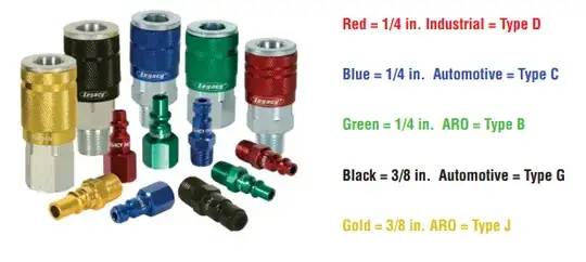

There are multiple types of quick-connect air line fittings that at first glance appear similar, but are not necessarily compatible. It is very likely that you have connected two incompatible types, resulting in a leak. This is very common.
The two "main" types are often referred to as "automotive" and "industrial", though each can have sub-types that are typically letter designations, e.g. Industrial can be M, H or G. There's also a type called ARO, and one called Lincoln, but these are somewhat less common (at least in the US consumer market).
air fittings
(image from Legacy Manufacturing)
The documentation for your air compressor may specify exactly which type of fitting you have. Otherwise head to the local big box store with your male coupling that leaks, and look for a similar-while-slightly-different male coupler to try.
