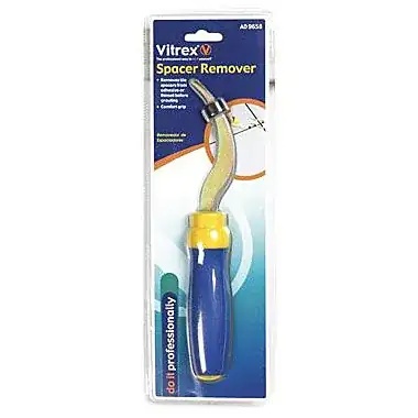

Clean joints are definitely preferable for a long lasting job. It's also worth mentioning that it's much easier to clean the mortar out while it's still soft. If you have a tool that is the exact same width as the grout lines it makes it easy to get them basically completely clean as you lay the tile. I recently completed a tile job using 1/8" spacing and used a "tile spacer remover" tool and it worked great for scraping out the excess mortar. alt text
