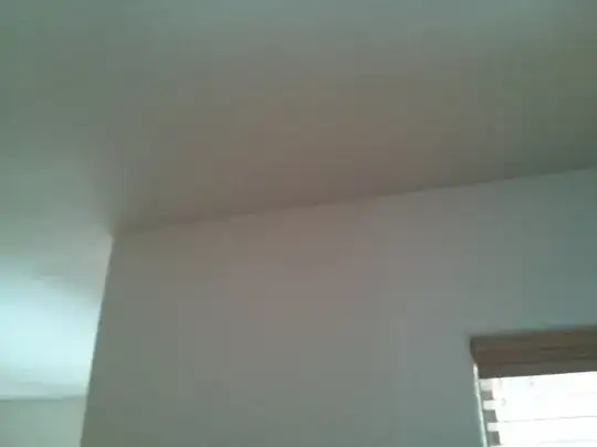

I am trying to mount speakers on the topmost part as you can see here:
Basically I am mounting it on that thin vertical area that you can see. Is this part wood or drywall? From tapping it, it sounds more solid. So does that mean it is wood?

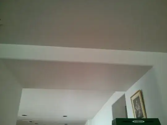

I am also going to mount speakers on the opposite side, at the top of the wall as well. It looks like this on the opposite side:
Would this be wood as well?

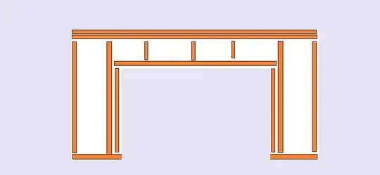

This is an example of a typical framing of the wall you describe
wall framing
The drywall covers the framing and the white areas in between.

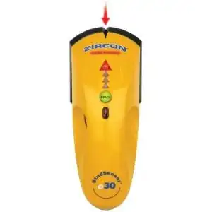

To find out where the studs are, you can use a stud finder.
stud finder
