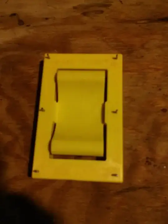

If you still don't want to use the rotary tool, there is another option. There are tools that attach to plastic electric boxes. You put them on and then position the drywall where it will be installed. Press the drywall against the tool, and it will place small perforations at the outside corners of the box. Connect the dots and cut. The image below is of one of mine, but I haven't had the chance to use it yet.
Thing that attaches to plastic boxes
